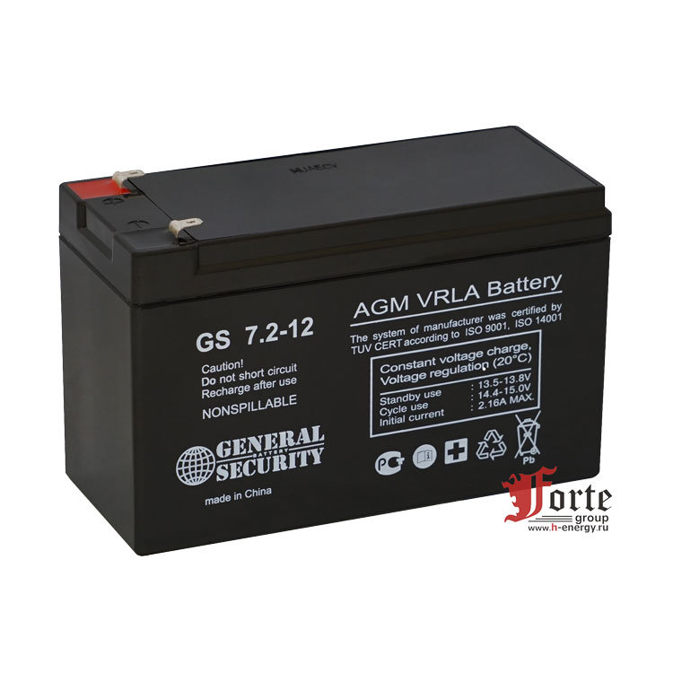

_gari 4 January 20 Posted January 20 (edited) · Report post читайте что там в рамочке на борту акб написано Edited January 20 by _gari Quote Share this post Link to post Share on other sites More sharing options...
